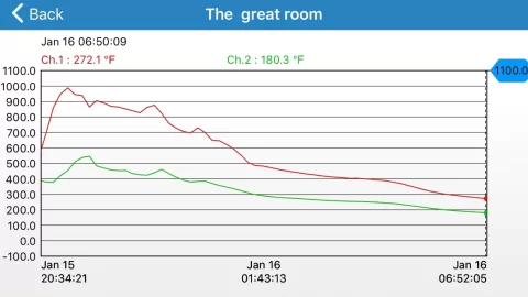

[Hearth.com] Blower on or off? Look at the charts. [Hearth.com] Blower on or off? Look at the charts. Regency f 3500 cat stove here is a chart of red temps inside the stove green the stove top. The top is blower on bottom blower off.

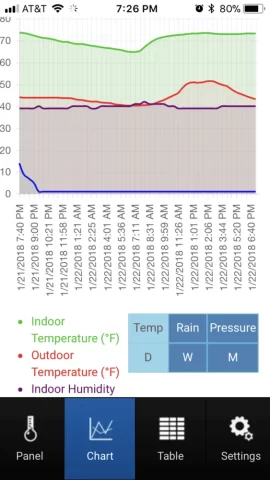

Interesting, yet at the same time, I don't see anything surprising. The real interesting chart would include room temperature, but it'd be almost impossible to isolate all the variables that might affect that.
TE

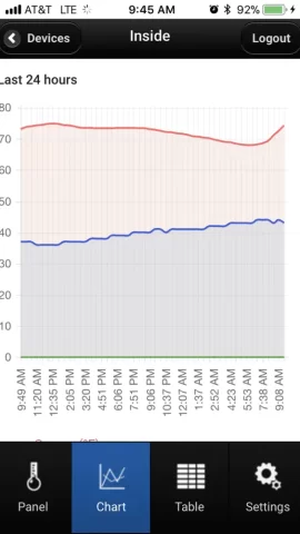

That is a good point with room temp and yes a lot of variables to compare, outside temp I do have on this chart, but need the exact in house conditions like no oven on for example. I only have the chart for today my thermometer does not go that far back.
I will try tomorrow to see inside temps with the fan on outside temps maybe slightly warmer.

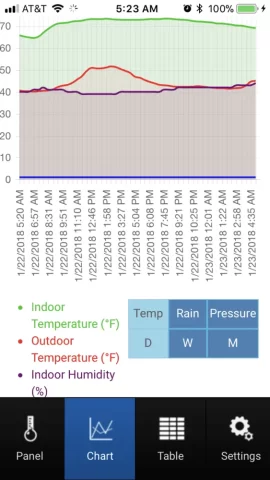

After back to back 24 hour burns the graph shows room temp yesterday morning with fan on and this morning fan off similar conditions except the burn with fan on I believe had one piece of wood less, yesterday morning room temp was 64.6 fan on this morning 68.4 fan off.
No I have a tower fan at the doorway blowing cold air into the room and warm air out.

Nice, like the data!
Room temps and heat demand would be a variable, however, I think it's obvious that by far the biggest variable is the amount of air circulating around the stove. As you pull heat off faster, you'll get cooler temps. The other vars, relative to fan/no fan, will be comparably small.
What would be an interesting graph is letting each of these play out to the same temp to try to measure total heat delivered, and whether or not they're different, but I think that would necessitate a probe into the flue.

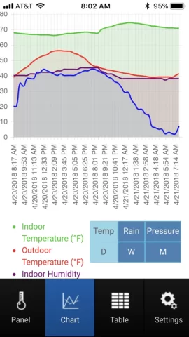

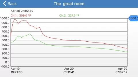

Ok here’s the chart for inside temps and in the stove temps fan on and off.
This is inside temps green line is inside red line outside temps 4/20 at 8am the inside temps was 68 fan off on 4/21 7am same outside temps fan on inside temps 71. Same amount of wood for over night burn.

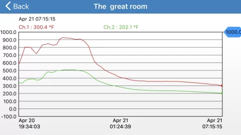

Inside stove temps fan off.

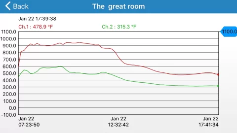

Inside stove temp fan on.

This is from last winter but I’m thinking from the data and observing this fall burning that with the blower on it delivers heat faster around the house but as the wood burns down the fan cools off the stove and temps may drop faster around the house. So if I’m doing 24hr burn times no fan on colder days fill with more wood open air little more but fill stove more often. Will continue to look at date and report. But discussing, experimenting and learning is half the fun at least for me.
