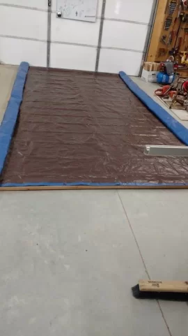

    Made a parking space for the Bolt in my heated shop. Did not want salt and water on the shop floor, and hopefully this tarp will prevent that from happening. Will need to mop up periodically. The Bolt is a little less than 14' long and 6' wide. The shop has 240V-200A service, lots of power for any charger.

    I would be worried about damage from things being trapped under the tarp. Salt water trapped down there.

    So glad we don't have to deal with road salt.

    It’s a nice parking spot, but where is the picture of the car? It’s sort of like those stove install pictures where there’s no fire burning.
