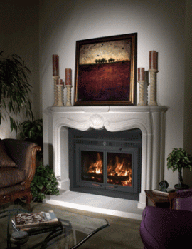

There is at least one dual-fuel fireplace that I remember seeing. It can be converted between gas and wood, but not instantly. You can't for instance use the gas to light a wood fire - there is a small procedure for making the conversion. And it is an insert - needs masonry fireplace to fit into.
Sorry I can't remember the manufacture, but if you search dual-fuel fireplaces, it should get you there.
(broken link removed to http://www.fuegoflame.com/Products_zero_c.htm)
Here it is.
