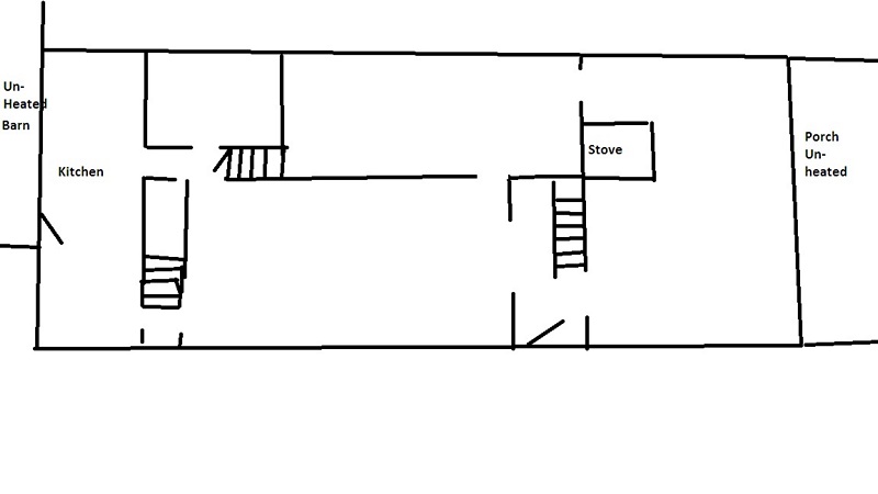

Crudely drawn floor plan of first floor

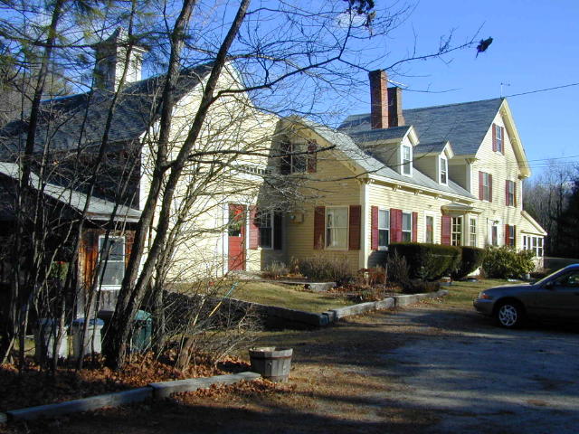

BTW, nice spread. I love those houses where the barn is attached to the kitchen. My grams place was like that. She had a little cast iron stove right there that she fed from the barn ...3feet away. !

Based on your floor plan , I would set up a clockwise flow, air directly across the front rooms toward kitchen . Now for the return across the back somehow (holes...power vents...) and block the front to rear opening just behind stove (to stop air from taking short cut) this can be a sheet or blanket... Point is you got to "tinker"
