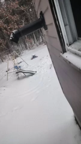

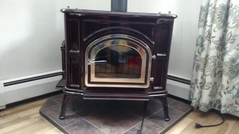

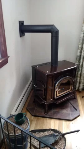

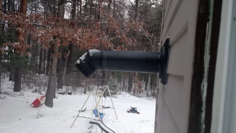

Here is how the stove was installed initially.
  • [Hearth.com] Breckwell SPC50 venting it myself and need help

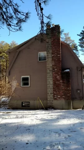

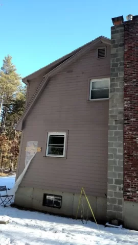

Here is the side of the house where the vent will run. The plastic and plywood is where the hole was cut in the house. I wish it was higher so more of the rise was inside, but its too late now. I removed the previous ventilation and am returning it to the dealer as a part of the refund agreement. (This guy has tried to make it difficult on me to get a refund as he insists I should let him fix the problem he failed to fix four times and only knew what the real issue was after I did the research.)

I agree. It would have been easier if your stove was located closer to the center if your home, reducing the height of the pelletvent running above the roof. You seem to have a few chimneys. Any unused flues?
The 10-2-3 rule is primarily for woodstove fire safety. However the higher you run your pelletvent, within reason, the less likely you will have draft issues. So, I recommend that you try to stick with those guidelines.

Note: In this Upland 207 Pellet Stove installation the homeowner replaced a pellet stove that exhausted out the back. Though not necessary for the SPC-50 or UP207P, the original stove's outlet was used to provide outside combustion air - easier than patching the hole.

I reviewed your photos again. That original outlet looks to be pretty close to your window. NFPA-211 requires at least a 4 ft. clearance.
Running the flue up past the edge of the roof minimizes the opportunity for exhaust gases finding their way back into the home.
You may be able to meet the 10:2 requirement without running the pipe above the peak of your roof. Bumping the pipe out past the gutters helps to knock down the needed height a little bit. (See above photo.)
