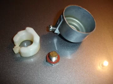

I've got an Iron & Oak 20-ton splitter with a Vanguard 6.5 hp on it. I've put a little over 50 hours on it with no problems.
Now it will only run with the choke half closed.

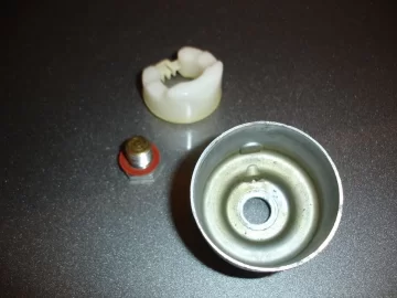

I theorized that the float arm had bent due to all the bouncing it experienced when I moved it on a trailer from CT to ME. I abandoned that theory after I dropped the bowl and found that the float is a one-piece molded plastic piece.
There's no metal wire holding the needle on either - it just slides into a slot on the plastic float.
Any ideas short of rebuilding the whole carb?
What kind of crud was in the bowl? 99 times out of a hundred the curse of leaving ethanol gas in it for extended periods has crapped up the carb if it only runs choked .

There was a small amount of solids in the bottom. I'd guess I'd describe it as what you'd expect to see after 50 hours.
I tried to be religious about adding Sta-Bil to the gas. Recently I've just been using 100% gas in my small engines.
The bowl bolt on most small 4 cycle carbs has 2 passages - vertical and horizontal. Run a thin wire (phone jack wire) thru them and spray with carb cleaner. Make sure the jet above this bolt is clean, too.
Yeah - I read that about some of the bigger horsepower Vanguard engines. Mine appears to just have a solid bolt that holds the bowl on.

Well, I threw it back together and put a heavy dose of Seafoam in the tank. Checked the tank vent - it was OK.
Spent a few hours splitting, but it still won't go without the choke on half. Looks like either disassembly or replacement is next.
