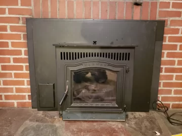

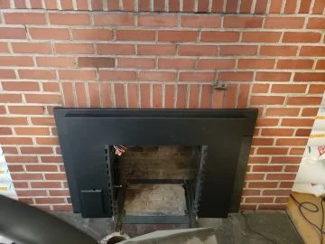

My 1100i died, just got an p35i with the small shroud. Problem fixed, reused the 1100i shroud.
