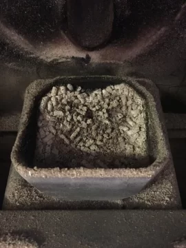

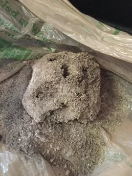

Hi there. I have had my pellet stove for a few years now with no issue. I bought it off Craigslist, so I never received a manual. The only brand name listed on the stove is Country Stoves. This year I have noticed that the burn pot is accumulating a lot of ash, and it is turning into a rock-like formation. I used to be able to go a few days before cleaning out the inside, but this year, if I run it on setting 3 or higher (5 settings) I have to clean out this rocklike ash clump everyday. It affects the look of the flame, and instead of a small clean and quick flame, the ash causes the flame to get large and loosely burning, which concerns me for fire safety reasons. I've never had this issue so I'm not sure where to start. We always use hard wood pellets. The photos I've attached are from this morning after using the stove on 4 overnight. Again, using the stove on this setting for this length of time was never an issue in the past.

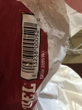

Post the upc label and we can determine the actaul brand.

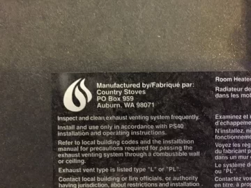

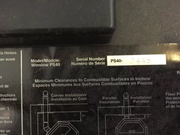

This is the only info on the stove I can see
Ok so you have a winslow ps40. Now you know what stove it so you should be able to download a manual for it.
Bit i meant the upc on the bags of the tsc pellets.. they use many brands of pellets and some are good and some are just bad..

Oh my fault! Here's the pellet upc....

Show a picture of the empty burn pot. I bet the holes are half blocked and smaller than they need to be. When you remove the burn pot, take a drill bit set and find one that fits snug into one of the cleanest holes. Then put it in a cordless drill and clean all the holes. You should see no, or very, very few silver metal shavings. But the holes should be fresh and clean and the same size.
