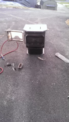

You need to pull the combustion blower and vacuum that whole cavity but you'll need a spare gasket to put back in as you'll likely tear the one you take out. Also, the area behind and inside the "firebrick" can get loaded up with ash that needs to get blown out. Search "leaf blower method" here or on youtube. It's a great way to clean your vent between full cleanings. Out of curiosity, how did you clean your vent? How long is the run?
Some people can't do this but I take my stove outside and blow it out with compressed air after every 1 - 1.5 ton burned.
******sorry I posted convection blower, meant to post pull the combustion blower******
