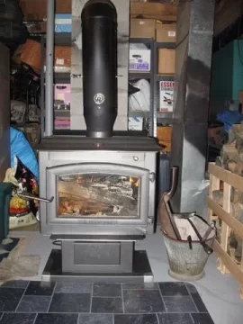

I burn 7 months straight 24/7 and don't have a furnace. For me, burn time is the length of sustainable burn cycles that keep the house warm. In other words, the coal bed doesn't get out of hand and fill the firebox but there also aren't long periods of burn down time when the stove isn't putting out enough heat to keep the house warm.
A ~100 pound load of dry primo wood in October easily goes a day and a half with an easy reload. The fastest I can fully burn that same load with the stove wide open and blowers going is 16 hours. I do 24 hour burn cycles of less than primo wood for the majority of the heating season and only get the good stuff out when I need it.

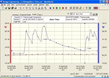

Here is a screen capture of burn time I made with my Omega wireless temp data logger.
I loaded it at about 9:00pm with a full load of maple. The fire box is 1.4cf, so it doesn't hold all that much.
About 40 min later stove hit 700 °F ambient temp about 80 °F .
8 hr later stove top temp 150 °F , ambient temp dropped to 73 °F .
I would say that is a solid 8 hr burn time. :-)

Man I want whatever that deal is that you have to record all that!
Can you point me in the right direction?
What is that red line for round 58.275?

8 hour burn time yes, meaningful heat for me would be anything right around 300 give or take a little.
Great way to record data! I think I can actually take a software program I use for my car to record fuel mixture and EGT and adapt it to monitor the wood stove. Hmmm Maybe I'll give it a shot. :lol: The program is known but what are you using for a thermocouple etc?
I'd love to see this data from different stoves so we could compare their burn characteristics. This would be a great way to fuel along the never ending cat vs non cat debate. :lol:
