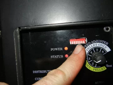

hey bioburner do you know what your dip switch settings are for your half and half mix? thanks

Looks like 1-2 up, 3-4-5 down 6-7-8 up.......lol
...and a fat finger too.....
Reactions: crizpynutz
Probably from to many carpentry projects. Thanks for the invention of air nailers it don't look like a thumb.
The cut out is there but just hidden by the plastic overlay. You should be able to feel where it is and with a sharp knife cut it out.
Thanks, Never noticed that on the cover. And I tore the face off the board to change my dip switches. Now if I get a new ESP off comes the tape.

thanks bio and yeah im gonna expose them switches like you did and it looks like a tooth pic is what you need to switch them? lol
Tooth pick, electronic plastic 'diddle stick', or a ball point pen tip.....
