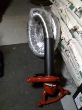

Checked Walmart, Sears, and Amazon for vacuum models and they don't seem to get any cheaper than around $50. I chose the Toro Ultra due to several top ratings including consumer reports and a higher CFM rating than the Weedeater model. My other concern was ease of adapting the intake tube to my liner. Not a lot of posts regarding connecting it so I figure I will have to improvise.

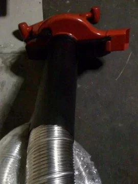

Good to hear you like the Toro, your video post convinced me to give the blower a try. What is your vent diameter? Did you have to cut down or alter the intake tube on the blower?
Update:
The Toro fits perfectly on a 4" flex liner so it is looking pretty promising. It is a perfect snug fit, no alterations or adapters needed. Just waiting for my brush to arrive to give it a try. Planning on slipping it over the liner in my masonry chimney and plugging it in from the ground. I will have to bust out the flip video camera for this one.
