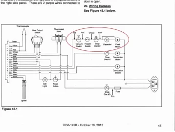

i have only had this happen once so far... flame or heat went up the feed shoot and tripped the snap disk #2...take the right side panel off and half in and up the reset will be there..
from the manual
17.
Snap Disc #2 (Fuel Delivery Interrupt) 175°F
Snap disc #2 is located on the center of the convection plenum above the convection blower. There is an orange and a black wire connected to it. This snap disc will turn off the feed system which will turn off the appliance if an over
fire condition should occur or if the convection blower should fail to operate. If this occurs you will have to manually reset the snap disc.
Power is not getting past the vacuum switch.
I can hear it "CLICK" when the exhaust fan turns on, so it seems to be mechanically working.
Is it abnormal for one of these to quit just a few months after install?
I'll jump it out & see if that fixes it (temporarily).
Jumping it out started the auger.

vacuum switch or the snap disk...to feed motor

Am I right that the vacuum switch should CLICK when it's actuated? I THINK it's the vac switch that's clicking.
I tried to remove the vacuum hose from the switch to see if it's clogged. It won't come off. It comes off of the pellet feed tube quite easily.
I jumped the wire going into the vacuum switch to the wire coming out of the vac switch... bypassing it completely.
The switch still has the hose going to the pellet feed tube. It still "clicks" when the exhaust fan turns on. I think you are correct... the contacts in the switch must have failed. That's a little disheartening, since the unit is only months old!
