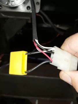

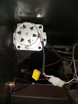

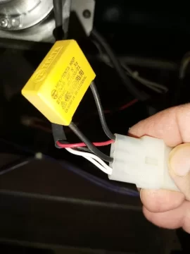

Not to hijack your thread, but I have a similar problem with my cab 50, I changed out the auger motor but my old auger motor had 2 wires to the connector, and this new one has 3. Does yours have 3 or 2? If it does have 3, any chance you can share a picture? Trying to figure out the wiring to mine.

Here you go, I hope that it helps!

I don't have time to take the side off the stove again but looking at the photos that I attached and the connector on my stove couples with flat 4 type connectors. On my stove there are two wires on both of the outside openings on the connector. The motor on my stove has four wires from the motor, a black, a red and 2 white wires. The 2 white go into the connector in the same slot. Blow the photos up that I attached and you should have no issues viewing the wiring configuration. Good luck!

Definitely looked like 2, I just wanted to confirm. Thanks again for your help!

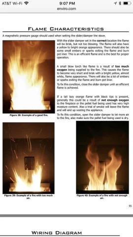

your manual HERE
I would start with setting the flame hight.
from the manual: A properly adjusted fire with the heat output control switch set on “high” has a short active flame pattern that extends out of the firepot approximately 4 to 8 inches (102 to 203mm). If the fire has tall flames with black tails and seems somewhat lazy, the feed rate will need to be reduced. This is done by sliding the fuel adjustment control rod down, which will reduce the feed (Figure 12.2). If the fire is not 4 to 8 inches (102 to 203mm) tall, slide the fuel adjustment control rod up to increase the feed. A medium and low setting will give a shorter flame. The flame will rise and fall somewhat. This is normal.
