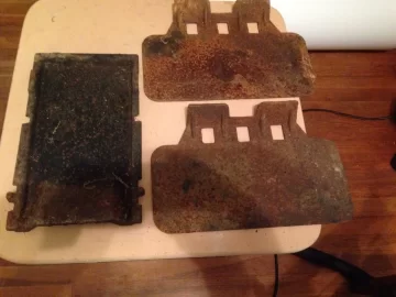

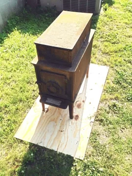

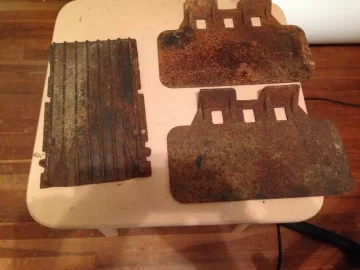

Hello. First time posting so hope mistakes are few. I do this from a phone also.
I picked up this old wood burning stove and was hoping somebody could ID it with a name.
I'm trying to figure out how all the inside parts go. Any help would be great. Thanks

Looks like another Jotul 118 knockoff. You could look at the parts diagram for the 118 on this site. Look up Jotul 118:
(broken link removed)
The side burn plates on the Jotul hang on the cleats that protrude from the upper inside wall. Then the arched baffle sits on the top edge of the side burn plates. Is this what you are asking about? Post of photo of the parts in question for verification.
PS: Look for an ID tag on the stove. We recently had a similar question and it turned out to be a Warmglow.
https://www.hearth.com/talk/threads/need-help-identifying-these-stoves.127953/
Great, that helps. The two plates on the right are the side burn plates. They go in first. Those three holes should have corresponding cleats (pegs) on the interior left and right sides. Install so that the top ledge is pointing inward. The right side piece is the baffle. I'm not sure how that fits in, but a guess would be that the blackened side is the bottom and the lipped edge is the back side. It sits on the ledge created by the burn plates. See how it fits.

Also. This was left outside and rusted up. I was planning on going over it with my wire brush on the air grinder. Would this be ok?
Also what do I need to put on it once I get the rust off? Sorry if I ask to many questions.
Sure, go for it. Wear gloves, goggles and an dust mask. The stove should be painted with a proper high-temp paint afterward. Vacuum off all dust, then wipe it down with acetone, alcohol or lacquer thinner before painting. Forest Paint's Stove Brite paint or Thurmolox's stove paint are good brands to use.

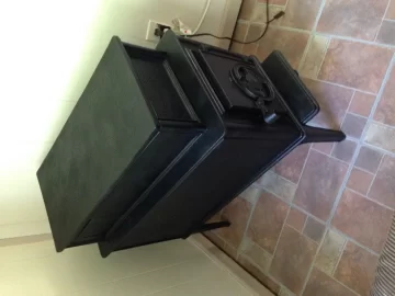

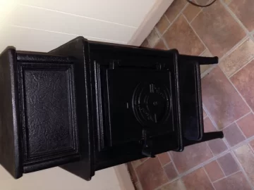

Beginning to clean it up today and it's coming along nicely. I did find a name on it and it's a Majestic. Went to there website but didn't see it there. I'll research more later. Back to the cleaning.
Have it all sanded down and blown and then wiped off with acetone. Have it painted and it's looking nice. Waiting on my wife to get home to try and get it moved inside now. If she has trouble with it I might try and help her. ;)
Pics to come of finished product.
Turn the phone the other way when you take'em.
Reactions: Dune
Good job. That heater looks really nice.
Cleaned up nicely! What paint did you use? Looks glossy but probably the lighting.
It's not that glossy but looks like it in the pics. I used Krylon BBQ Stove High Heat spray paint. Took me two cans to finish it. Paint drys in just a few min.
