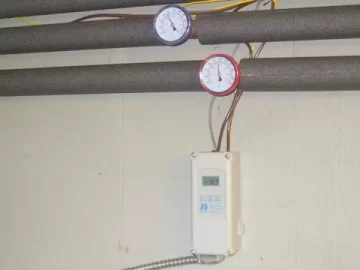

when you replumb this weekend put some gauges in so you can see where your hot and cold temps are if you can.

yes I did, my return water temp was to cold. I had a temp gauge installed but it was running 15 degrees to cold, so in turn I was cold shocking the boiler, and fouling the heat exchanger. The factory also has an update that I installed on the back of my Greenwood. It is a loop with a thermostat (like in your car) this will preheat the cold water returning to the boiler, preventing it from cold shock. It was a little pricey but I believe it took care of the problem. I also had another problem with one of my heat zones in the house. I did not have enough baseboard heaters, so that zone would always be calling for heat. So I fixed it by installing pex radiant floor heat. I will be connecting it next weekend.
