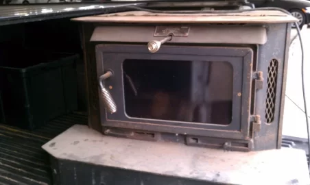

Can anyone tell me the make/model of this Applalchian?
38053wdw
Apr 29, 2014
4
Tennessee

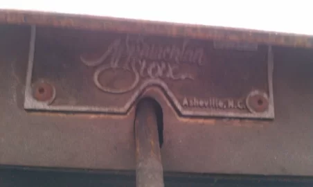

I just purchased this and was trying to find out some info on it. I'm going to clean her up over the summer and maybe use it. I have a Buck Stove now but the Ms. wants a window to see the flames. I will need some side panels for the FP opening and one of the front toggle switches is broken. I just want to see what they do (one on each side) - You can see the broken toggle switch in the bottom left of 2nd picture. Thanks in advance for your time.

I like that, kinda like a buck but with a single door, I prefer a one door with a large glass.
Richard
I think you might just have a nice stove there.
It's smaller then the one I have now ... So it may not work to well... Especially since I will probably have to make the side panels to cover the openings
