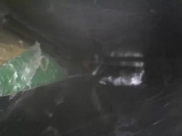

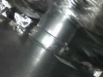

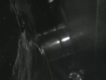

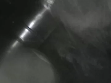

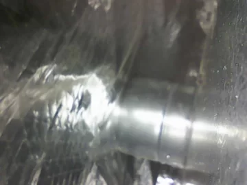

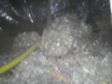

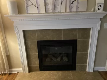

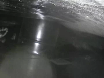

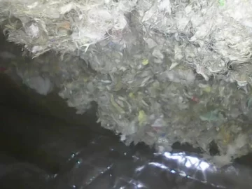

Ok so I got one of those little inspection camera and tried to go through one of those little holes in bottom of fireplace. It was hard to control but here are some pics of chase. Should there be all that insulation around bottom? Also look like side panels look funny. Could the insulation be giving off fumes?
View attachment 324438 View attachment 324439 View attachment 324440
The blown in insulation may have come from above, or below. If it came from above, there is probably more insulation sitting on top of the fireplace.Ok I guess the big question is it safe to use? It’s been that way for 8 years. Is this what is causing chemical smell? What is that silvery pleated stuff called lining the chase? Would it cause a smell. Thanks for all your helpI wonder if whoever put up that silver stuff bunched it around the fire stop? Kind of looks like that stuff is bunched up some
