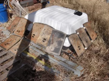

Below is Goldilocks solid doors. When draft caps are removed they have the raised circles like the ones for free.
Can't go by foundry markings. Some Goldi's have M1, others have MH for "Mobile Home".
That's just my guess !
I can weigh a set to let you know.
