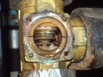

I am not sure if thats the same valve as I have or not . I just did rebuild on mine , new element and new gasket . I would call the guys at Tarm for the part .If you are realy good you could run to your local auto store [Hearth.com] can the termovar mixing valve be rebuilt? [Hearth.com] can the termovar mixing valve be rebuilt? [Hearth.com] can the termovar mixing valve be rebuilt? and get some thin gasket mterial and cut it your self but the gasket is very small and would need to be cut almost 100% correct . As far as the leak mine leaked for the last 8 years , not much but if the piping was cold there were a few drips on the floor . Just a hint I got when you put in the new gasket use vasoline on the gasket .
I am not sure if thats the same valve as I have or not . I just did rebuild on mine , new element and new gasket . I would call the guys at Tarm for the part .If you are realy good you could run to your local auto store View attachment 129290 View attachment 129291 View attachment 129292 and get some thin gasket mterial and cut it your self but the gasket is very small and would need to be cut almost 100% correct . As far as the leak mine leaked for the last 8 years , not much but if the piping was cold there were a few drips on the floor . Just a hint I got when you put in the new gasket use vasoline on the gasket .
That sure looks like mine right down to the corrosion!

As I can remember the element and gasket was like 75 bucks , I think . But if you dont need the element then its just the gasket . Depending on how your system is will depend on your amount of water loss and purging . In my case I have 5 ball valves to close and at that time I can change my 2 pumps and the termovar . Above my two pumps and termovar I have a riser with a manual bleeder . I would say my total loss of water is about a gallon or so . As far as the gasket goes you have two little screws that hold the face plate on and under the face plate is 4 screws in the corners that hold the cover on and then gasket . Dont expect to get the gasket out at all in fact I think most of my gasket was deteriorated gone , but then I was running antifreeze in my system and I have heard thats hard on gaskets . Once you have the two face plate screws out and the 4 corner screws out thats all the hand tools you need . Under the cover you will see that there are two half moon shaped cylidrical brass pieces , like in the last picture , That more or less is an assembly of the thermostatic element being held in place by the spring which puts pressure between the two halves to hold them in place in the termovar housing as you see in the last picture . Just work the two halfs out togeather and the assembly will fall apart , Just remember how it was put togeather there are only 4 pieces total but they need to be installed correctly .
This whole project is way way very easy . If you do take the cover off to change the gasket I would at least take apart the rest an make sure that there is nothing wedged in your element as I found a small piece of teflon tape in mine keeping it from closing all the way .
