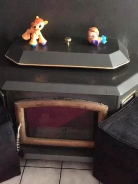

Does anyone know what brand it is? It's free, but the owner is saying the auger is broken. Is it repairable?

The door trim makes me think Whitfield, but I am not sure. If you take it, you should be able to find some sort of label in the back telling you the maker and model. And if you pull the auger motor, there is likely to be some marking for revolutions and speed which should let you match it up on ebay, amazon and other online sellers of pellet augers. The trickier part is if something else is wrong with it like the board. But hey, it's free.
