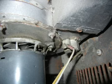

The proof of fire snap switch in the exhaust path by the exhaust fan will shut down the stove if not above 130F I believe.
  • [Hearth.com] Canwick Pellets in a whitfield quest
