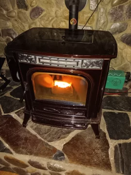

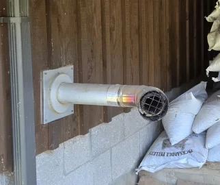

My question is about VENT-PIPE ASH! How often do you clean it out during the winter and what method do you use to do so? I have a very old Whitfield Quest pellet stove (first pellet stove ever mass marketed) that came with the home we purchased almost twenty years ago, It's in the basement, but I only started using it full-time this winter because i moved my office there. Refurbished it last year and it's working fantastically well now and it's a blessing against the sub-zero temps we get here in the Colorado Rockies. However, after the first 45 days or so of using it, I inspected the vent-pipe tip for any kind of buildup and, low and behold--lots of dry ash. I'm estimating possibly twenty percent closure of the lumen. So of course, I disassembled the exterior vent pipes and brushed them all out real good. It was all DRY ash, no gooey stuff, so that was reassuring. And I'm using what I think are high-quality pellets, so I'm not at the moment worried too much about creosote buidup. I also used a Shop Vac to pull ash out of the exhaust path. BUT...now I'm kind of focused on keeping the vent pipes from clogging up from ash. And I'm now wondering what the consequences of a semi-complete closure of the vent pipe would be. Surprisingly, I haven't run across very much discussion of this subject online anywhere; maybe I'm just not digging deep enough. But anyway, I'd like some opinions from other pellet stove owners on this.

Welcome to the forum. I clean out my vent pipe once/year or after 2 tons of pellets burned. The vent has a screen with large openings (1") where it exhausts and does require me to remove for cleaning but the buildup is usually not significant. The screen is necessary to keep the critters out of the pipe in the off season. Perhaps the screen on the end of your vent pipe is too small.

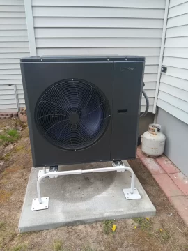

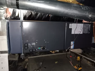

Clean mine about once a year in Spring. Use Brush and then Leaf Blower. This year not going to clean it. Got Low Temp Heat Pump. Burned 1.5 bags of pellets. So no need to do it. (Midea G3 Evox Unit - 3 Tons). I replaced Wood Stove spring of 2018 with Harmon XXV. So I have 8" Pipe for Chimney. Some ash collects in pipe going out the wall. Brush and Leaf Blower solve that quite nicely. Learning this new Heat Pump (Replace 2001 Unit that was OLD and did not work well past 30f). Elec Use this Month is actually down from last year. Very Warm Winter. Almost 10% less electricity used. "Jan 2025, 5623kw used vs Jan 2026 4753kw. Saving the costs for 3 Tons of Pellets so far. I have used it when I wanted quicker temp rise in Living Room. Few hours then turn off.

Thanks. No, actually my vent screen does have 1" openings as well. Looks like the pellets I use (Big-R brand/Colorado), which are the lowest-ash ones I've found so far where I live, are going to require a couple of pipe-cleanings a season. Oh well, easier than dealing with a wood stove, I think, so I'm okay with that.
