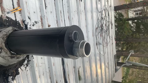

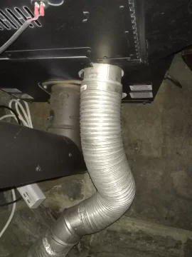

Here’s an install I did of a P61-A using a 10” existing setup

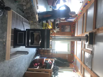

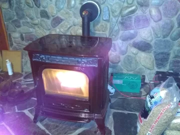

I switched from Wood Stove to Harmon XXV in Spring 2018. I just used chimney that was there. 8" works fine for pellet stove. Clean it once per year.

Starting at figure 4.3 and then 4.4 ect they do have options for you to use an existing chimney but recommend a 4" liner. I'd have 4" all the way to the top in the chimney. Then use double wall 4" duravent pellet to get into the liner.
