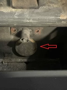

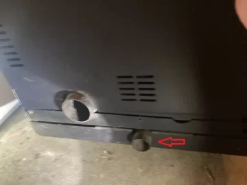

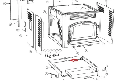

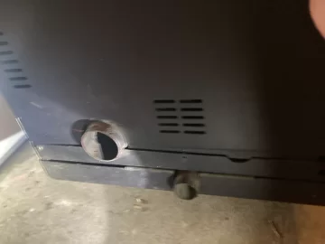

So I just picked up a ussc 6041i, I was doing the research on the fresh air kit to run up the chimney next to the exhaust liner. I too the back panel off the stove today and found that the 6041i is a bit different than the 6041s. The fresh air hook up on the back of the stove goes in below the stove and it looks like it’s just open to everything under there. I found the fresh air intake hole on the back side of the burner chamber, looks like I’ll have to add my own connector like they do on the regular 6041’s. Anyone worked around this before? I also just thought about leaving the whole back panel off and connecting the 3” intake to the port on the back of the burn chamber.

I'm not sure I understand the issue. On the back is the exhaust outlet, and fresh air intake coming out of the rear cover.
I guess you are saying that fresh air tube does not go directly into the stove, but just brings air under the stove?
You want to hook up directly to the firebox fresh air inside the covered area?
I personally would leave it as be and keep the cover on.
Is there no way you can bore a hole for fresh air from outside? If your cleanout is outside you can use that path.

so the stove i have is an insert. so its slightly different than the pedestal version. if you look at the first post in this thread you will see a short section on pipe welded to the back of the stove for the fresh air intake. mine is in the very bottom and has no way to connect to the pipe on the inside of my stove that goes to the bottom of the burn pot. My ash clean out goes into my basement with no easy way to run it to the outside. My thought was to get a "co liner" cap and run the 4" exhaust up with a 3" Fresh air. chimney is only about 13feet or so. Ive done a lot of air sealing and insulating to my house and im worried that it wont leak enough air to feed the stove.

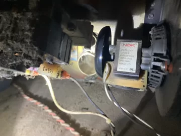

While I have never installed a 6041i , I have installed many 6041's. Are you saying under the burn pot between the ignitor and the slide damper there is NOT a cap? (air 3) This cap is removed for the Outside Air Kit. A piece of flex pipe is installed from the back of this cap hole (air) to the back of the air outlet in the frame. (air 4) Then flex pipe is installed from the front of air outlet (air 2) to the outside of your house and yes you can run it up the chimney as long as the outlet is below the exhaust outlet. (air 5)
i do have a cap like pictured in air3. there is no opening to connect the capped fresh air intake to the cold air intake in air4. the cold air hook up on the back of the stove is open to the whole bottom where the ash pan is, lots of openings and holes in that lower pan pictured in air4. thats where my question comes in. in air2 just above the arrow you can see the little half circle on the main frame of the stove where the pedestal outside air intake would be. hopefully that makes sense. the only way to get true outside air is to put a hole in the back panel pictured in air2 or take that panel off all together and connect the outside air right to the intake pictured below the igniter in air.

That link is great. Cap is pictured in air 3 pic. On my 6039 I drilled four 3/8 inch holes and put cap back on. If I burn straight pellets I do not have slide damper open, control board controls how much air is being pulled through the 4 holes. If I am burning corn or corn/pellet mixture I have to open slide damper 1/2 inch for more air or use the control board to increase draft. I tried the ball valve in the cold air intake but could never get the draft tuned in right. I tried leaving the cap completely off but it burned with to much draft sucking the heat out the exhaust even though I turned down draft with control board. I think I have to much natural draft to leave cap completely off.

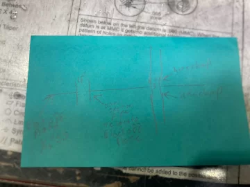

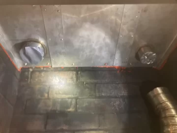

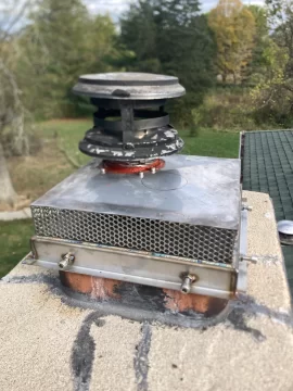

so I've got the old wood stove out, planning the block off plate. ill be running the 4" ss flex along with a 3" aluminum fresh air line up the chimney. from all the stuff I've seen for block off plates people just cut the smallest hole possible to allow the liner though, I'm thinking about welding a 4" and 3" section on pipe into the block off plate. the top part of the liner would attach to the top and then the lower part that connects to the back of the pellet stove would attach to the bottom part of the block off plate. hopefully that makes sense?
Edit:added terrible drawing

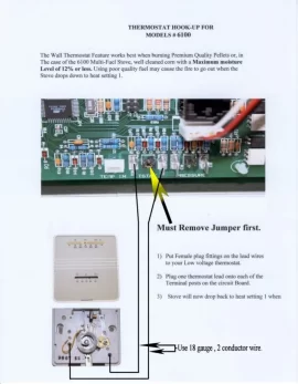

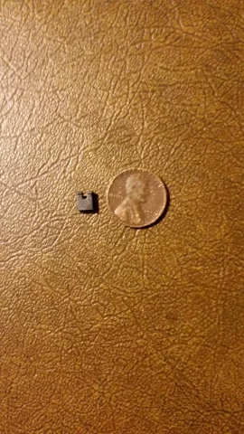

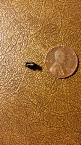

My thermostat jumpers dont seem to do anything? I took the little jumper of between them but it still doesn’t seem to work? Anything else to look at?
Reactions: ARC
What thermostat do you have it hooked to? You are aware that the 6041 does not turn OFF unless you push off button. Unlike some stoves that shut down and restart. When on thermostat the stove will go to idle when the thermostat reaches set temperature then when thermostat ask for heat again fire will ramp up to what ever heat range you have stove set to. The heat range number will remain on whatever range you set, the dash between the letter and number will flash if stove is ramping up or down and while in idle. So if you have stove set to heat range 1 you will see no difference whether thermostat is asking for heat or not, even heat range 2 is little difference in flame. Just look for the blinking dash to tell if controller is doing something.
Pic of jumper and thermostat instructions below
