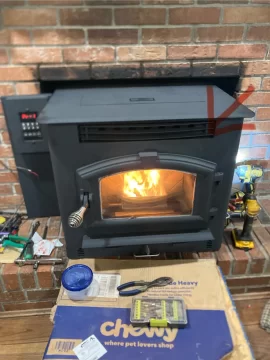

The EGT probe is after the exhaust fan in the aluminum adapter. The room air temp is another thermocouple that I drilled a small hole in the side of the room air flow. It’s under the side panel of the stove so you can’t see it. See arrow- it’s pointing a little low but it’s in that air stream

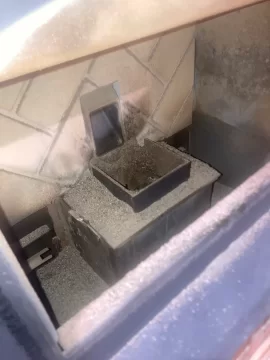

Are the holes behind your backer board sealed, most plug those holes with 1 1/2 plugs for electrical box. Plugging them stops some heat from escaping out of the firebox into the exhaust path. Picture is my 6039 but you should have holes in B location on each side of your chute. Good thing about the plugs is they are easily removed so you can brush between the walls weekly.

No but some state it helps direct the air flow more through the pot. I think the engineers got it right when they built the 6041 runs good straight from the factory. It is a solid noisy heat throwing machine.

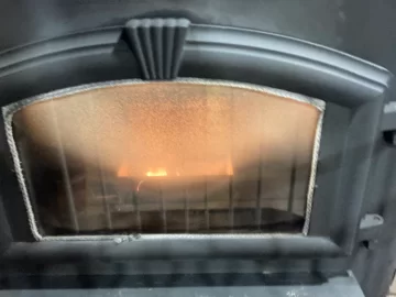

How’s my glass look for two and a half days of continuous running? Also I’ve fixed my un burnt pellet problem by increasing the air flow slightly. The new temps reflect the increased air flow. Room air temp 135f and EGT 275f. So slightly less efficient but burning better.
Looks about right especially if you have been burning on lower settings. Mine looks about same after a week and it has been burning on higher settings most nights have been in teens. Day time it has been going into idle for hours at a time which causes more soot/ash on glass. I tried to take picture but wifes new phone doesn't like brightness of fire can not see glass. Had to take vid with old Iphone.

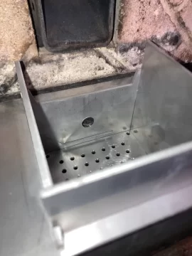

I’m contemplating making a smaller burn pot, similar to the square ones in the 5500. My house requires less than 3pph at 15f outside. I’d also like to get the low end burn rate down to around 1pph or possibly a little lower. I can’t seem to do that with the huge burn pot in this stove. Time will tell lol
Alright, got an update! I’m going to have to make some modifications but overall the initial testing has been amazing. Still need some long term running to see for sure. New burn pot is in. Low fire rate set at 1pph ! The crazy thing is the efficiency. So with the original burn pot at 1.45pph I was getting a room air temp of 135 EGT 270. New burn pot is 140room air and 230EGT! So I’m keeping way more of the heat! We are supposed to have sun zero temps this weekend so it will be getting lots of testing. The video is at 1pph.

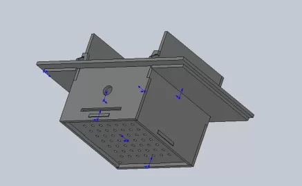

Started the stove Saturday morning. Made it through the -4 temps 2.85 pph was all it needed to keep the main part of the house warm at that temp. The bedrooms were a little chilly lol time to do a deep clean while the temps are a warmer. The new burn pot worked well, had to open up a few holes.
