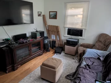

Essentially, I have a ~1100 sqft home with an unfinished basement and an exposed ceiling. I primarily spend my time on the first floor of my house and keep the temp around 65 in the winter time.
My thought or hope is to install a stove in the basement for ease of placement and installation and my hope is that it will warm up the basement and allow the heat to rise and keep my first floor at a comfortable (for me) temp. If needed I could and would be willing to cut vents/holes in the floor but would prefer to start without them.

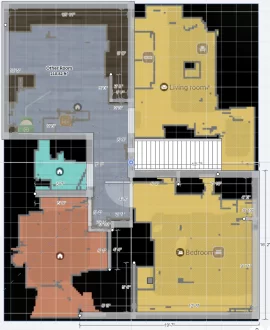

I have tried to attach a few images here which is a rough floor plan of my house from my vacuum cleaner which I know is probably not super accurate and I tried to use a floor plan website to estimate some distances/sizes for walls etc but please note these may not be accurate, I can always get more accurate measurements when I am home.
I understand putting it on the main floor would be the most efficient option however my place is fairly small, the floor plan is fairly closed off and its not like there is a lot of circulation or easy access from room to room without it being more open. If anything the living room would make the most sense however based on my picture there really is not much room to put a stove. It seems the best location would be where my recliner is (to the right of my AC in the image) however then I would be getting rid of seating. Where the image is taken from is next to the front door/staircase upstairs.

If your basement is unfinished = not insulated, then 1/3 or so of the heat (pellets) you're paying for will disappear to the outside.
I'd not put a heater there unless you insulate it.
Once insulated, it'll help offset your ground floor heating for sure.
Note that cutting holes in the floor may be against fire code. Your wood floor is a fire barrier (yes, wood burns, but it takes a while go get through, giving you more time to get to safety).
Best to have firedamper (a valve that is spring loaded and will close when it gets hot (140 F or so) because it's held back by something akin to soldering alloy.
Also, make sure that the air can flow in "circles". Have a route for colder air to come down and a different place for warmer air to go up. Otherwise you get mixing at the one connection (e.g. stairs), leading to much less heat being transported up.

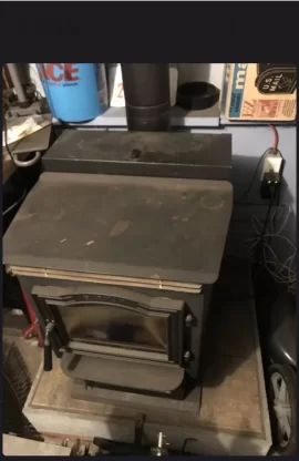

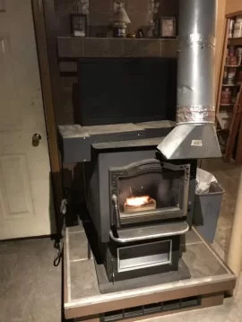

A pellet stove is a space heater but with a Harman P61a, the space I heat is my whole house. The location is key. The house is a split entry with insulated basement and it is located in the middle of the basement from front to back and side to side and pumped into the block chimney with a super efficient Selkirk DT Masonry Chimney kit that pulls in and warms the burn air with a special chimney top and liner.
Also have a backup in the garage which can heat most of the house in a pinch with the door from the basement to the garage open. :-)

Don, the difference is that you know and are skilled at doing the necessary mods
I could do it here, but being a two-story centre-hall plan, unless I put the stove by my front door facing the stairs, I would not do the job. Besides, my wife would kill me if I moved out of her beloved family room . It is all in the layout, but you have an interesting set-up
I know you are feeling that you have limited space but ask yourself what you are doing with a particular corner of a room on the first floor. Pellet stoves often have required clearances of only several inches from walls/combustibles. It may take less space and be less in the way than you think. If on the first floor, you may even get away with a slightly smaller stove and heat the house quite well. Win-win.
I installed a Harman P61 in a friends basement, walls insulated but ceiling not, warmed the floor of the first floor nicely and he’s quite happy with it, approximately 1000 sq ft
