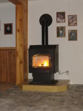

my wife and I would like to put carpet back down in our living room. What are the guide lines about carpeting around pellet stoves? Clearance? Looks of it? Safety?
Do any of you have carpet in the same room?
Yep, hearth pad is sittin on top of carpet.
Proper clearances are maintained.
Had mine on carpet. This summer i replaced it hardwood flooring. Never a problem here!
  • [Hearth.com] carpeting with pellet stove

We have two stoves that are sitting over carpet.
Just placed the floor protector pads right down on the carpet and did the install.
In the family room, we had carpet, then removed it to install heavy duty vinyl.
Left the stove right where it was, cut the carpet and then once the vinyl was down, just trimmed the edge of the hearth pad with a wood moulding.
We then tore that stove out and I installed the raised hearth.
This left a blank spot where the old stove was, but the new hearth covered that all up anyway.
Should not be any issues to reinstall the carpet.
You can either remove the stove temporarily and then do the carpet and then replace the stove, or carpet around the stove or up to it and trim it out.
