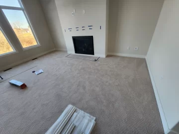

Here is a picture of the room. I would have to roll the carpet off the back wall and leave the carpet partly rolled up in the middle of the room. I think that would get in the way of the stone installers.
The problem is I can't get the stone installer and carpet installer at the same time. I need the carpet people to completely finish their work first. This is why I was thinking about having them make the cuts and just leave a hole in the carpet ready to go for a hearth. I can have the limestone hearth custom made to the exact size of the carpet cutout.

I think you have the two contractors work it out, however the order of the job is roll the carpet back half way in the room, then build the hearth. Any contractor can roll the carpet back.
And any contractor can step over 10" of a carpet roll...?

But I don't think contractors, working on construction sites, would have an issue stepping over something like this. Not much more than 1.5 times a stairs step.
Contractors are used the working in messy places.

It is a valid point. They will probably frame it up in a garage or outside, but the cutting of stone or tile and mixing ext is done outside. The white hat safety managers are always looking for tripping hazards on work sites. It only takes a second or a distraction and a person could trip. The extra effort to roll it back further is not a big deal. Just remember if you don't get the carpet company to do it, you will have more liability in case someone damages the carpet. It needs to be "un-kicked out" gently
