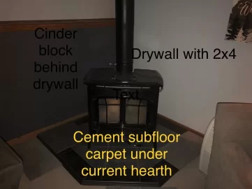

I have a hearthstone Bennington stove that currently is sitting on a hearth pad (prefab) that is sitting on carpeting. Double wall pipe. The floor in the room is a cement floor (so cement floor with carpet on top). The stove sits in a corner with both walls drywall and one wall is made out of 2x4 and other is the foundation wall that is made out of cinder blocks (likely some spacer over the cinder blocks and that is how the drywall is attached. This stove was installed by a fireplace company fyi

2) I am contemplating laying brick for the hearth pad as that would seem easiest but do I need to insulate the cement floor before I lay the brick and how the heck would I do that? Alternatively I was going to build a wood base out of 2 by 4 and 3/4 plywood then add micro 300 over the plywood and then cement board to get above 0.9 r value then decorate that with tile on the top and stone veneer the vertical surfaces. I have never worked with micro 300 but how do u secure it and the cement board to the micro 300 or can u just tile over the micro 300?

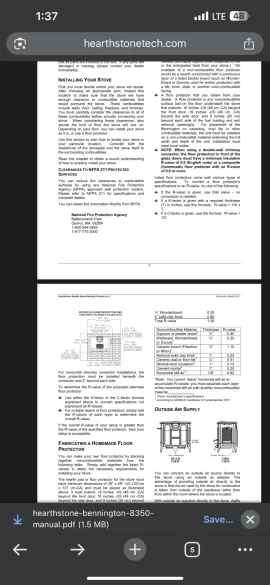

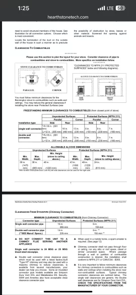

I posted the specs from my stove booklet and a couple of ways I’m trying to construct this so I have an idea of what I’m thinking (as best u can)

Just to clarify and understand I am reading the manual correctly.
1) i can have a non combustible material as close as 7 inches to the corner of the fireplace but a combustible has to be 12 inches?

Yes, clearance requirements are to the nearest combustible.

From the manual:
Install your stove on one of the following:
A non-combustible floor, such as a slab, cement, or stone hearth. (A noncombustible floor will not ignite, burn, support combustion, or release flammable vapors when subjected to fire or the anticipated heat from your stove.
If a wooden raised hearth base is used, then something must be used to insulate the wood up to an R=.9 value. This could be 2 layers of Durock NexGen cement board or 1/2" of micore, then 1/2" cement board that is screwed every 8". The micore layer is held captive by the screws, no adhesive is used to secure it.
