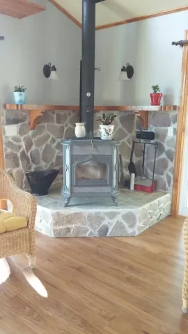

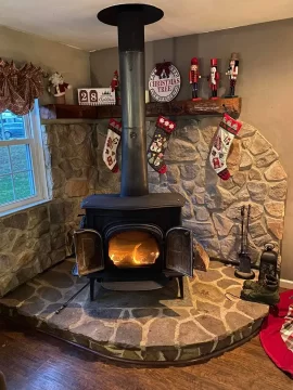

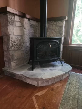

Here are some examples of the look that I am trying to achieve. Much appreciated!

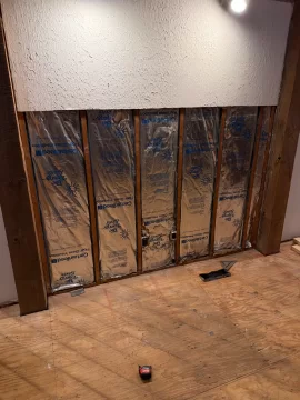

[Hearth.com] Tips for building a natural stone hearth[Hearth.com] Tips for building a natural stone hearth[Hearth.com] Tips for building a natural stone hearth
The starting point is to figure out what size it needs to be and what R value you need. Since you know the material you want to use, you can then figure out how thick it needs to be for that r value.
Ok. So your wall insulation has nothing to do with this. Your stove puts off heat. This radiates out and without protection for the wall and floor, can set them on fire. You need to find out how much protection your wall and floor needs so you don’t set your house on fire.
Oh r value from the stove. Gotcha. This cabin has been here for 46 years and the was literally nothing but dry wall on the back and some crappy tile beneath. Never had any issue. In the 10 years that we’ve had I’ve been very aware of it and it’s never seemed like it’s putting out enough heat to be a problem.
I’m re-building it with backer board, thick mortar, and thick natural stone. The insulation from the heat will be way better by default.
This type of damage doesn’t happen quick. Don’t fool yourself. Do it right.
He’s a chimney sweep. I’m sure he’s opened a few walls that have always been fine… until they weren’t.

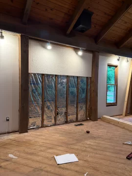

This is one that caught fire after about 60 years of use we had to rebuild
The point is this: long (decades of) exposure to too much heat can lower the auto-ignition temperature of wood. I.e. you're all good for half a century, and suddenly you have a fire in the wall.
So read the manual of your stove, and look at the clearances. Those are the distances from teh stove *to the first combustible piece* (In your case the paper on the drywall). It doesn't matter if there's noncombustible (stone) in front of it.
