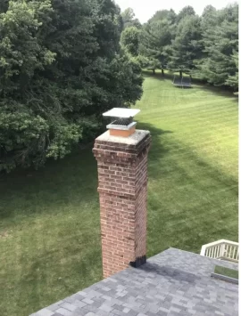

Before I order all the parts, I wanted to run it by some more seasoned folks. My chimney is ~21’ from the throat damper to top of the terra cotta. It has a 10” stainless liner that appears to have poured insulation around it. The damper opening is just shy of 6”. Im planning on running a 6” Olympia 0.010” hybrid liner through the existing liner, which seems like it should fit pretty comfortably once I cut out the lip off the damper frame. I’m debating whether or not to add additional insulation, but leaning toward adding a 1/2” blanket. Is this worth the additional cost and effort?

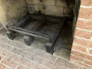

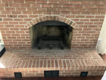

One odd part of this install is the fire grates. They are square tube steel mortared into the hearth and appear to be part of a heatilator type setup, though I’ve never seen one quite like this. I imagine I’ll have to cut them off flush to the brick. Has anyone encountered a situation like this before?

That grate along with the vents below it does look like some kind of attempt at a heat recovery device. What is the vintage of this fireplace and house? Anyway, a cutoff wheel on an angle grinder would make short work of that and you can fill the remaining holes with mortar.

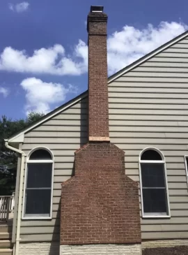

That chimney rises pretty high above the roof. How are you planning to get the liner in there? Do you have access to some staging or a lift you can use?

I don’t have a lift but I can get up to the top with an extension ladder on leveling feet. Getting the liner up there and running it down would definitely be tricky. I was hoping I could pull the liner from the bottom with someone helping push it up. It’s a pretty straight shot once it’s through the damper.

If you insist on the ladder be super safe. Personally I get a towable lift for the second half of the day. Make some type of crank winch to help pull the liner up. Make sure you know how you will keep it in place (not falling down. ) to get the top plate on. It’s going to take a lot more work than you think.

The existing liner is a straight shot from just above the damper (see crappy quality picture below) so I’m hoping it won’t be too difficult to pull/push through.
As far as the ladder situation. I inspected the crown using a 36’ ladder from the ground but I can use an 8’ ladder with a wedge to access it from the roof, which should be a lot more comfortable. If I’m unable to pull it up I’ll have to rent a lift.

You can try pulling it up if you have some help pushing from the bottom, but usually it's easier to drop from the top, gravity on your side and all that. Since you've got a helper, I'd have him stand on the roof and manage the loose end of the liner while you stuff it down.
If you can do it safely from the ladder - great. You are able to assess the situation better than anyone here on this forum. Renting the lift could be a worthwhile one-time expense to change this job from hair-raising to easy-peasy.
