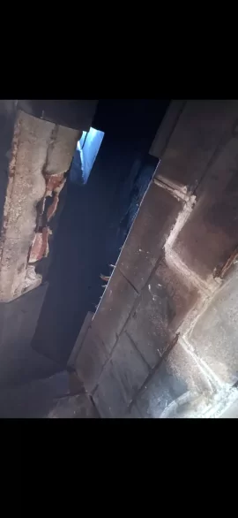

Can you post a picture or two looking up at the damper area?

Here's a couple horrible pics , so in the open position I can barely get my hand in the throat but what I feel on both sides which is to say the front and the back of the damper is just solid brick, concrete or some kind of masonry. I can easily remove the door part and maybe cut out the fixed side which in my case is at the front of the chimney. Then I guess chip away at whatever is up there to allow for 6-in, too bad I couldn't see what's up above the damper frame.

Yes, it looks like removing the damper and cutting a notch into the damper frame should provide the clearance needed.
I cut mine right out and actually had to remove some of the damper frame and chisel away a small amount of protruding brick to make mine fit. This was an insulated 6” liner
