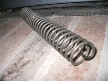

No problem. Remember on the springs to put a bend in the one end like my picture shows so you can twist it to get it in. It won't (shouldn't) slide in. It's a tight fit, which is exactly what you want for heat transfer.

Hey tjnatiw, I installed the springs...I only had to twist one of them in...the others slid in but I think they are tight enough...I feel a difference in the heat output just by holding my hand in front of it...on high I cant even keep my hand there too long :) One question, can they go too far down the tubes? I don't know how the air is blown in and don't want to block the entrance...
No, they won't block the airflow, as far as I know. Just keep them flush with the front of the tubes. I'm surprised that they slid in. I had to really twist to get mine in. I'm glad it's working for you! Happy heat!
Thanks, after running it with the springs in they tightened up...even the ones the slid in now are in there good :-)
