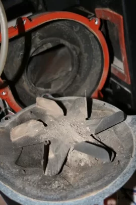

Did my first ton cleaning so far this year and was very happy that quad combustion gasket part number 812470 I think is not the crappy white one. Replaced with a nice red rtv type
So hopefully this may last a while. Anyone else replace and after cleaning able to use again

I can't even find it in my parts list. Only orange reusable gasket I know of is for the AE. Time to do some snooping I guess. kap
Ya I was surprised myself. It's out there home and hearth part so it's for real. I hope I get a few uses out of it.
I typed the part # into my parts list and it wouldn't come up. If it is like the AE one, you will. Nice to see them doing it with the other stoves. Hope they do it for the rest too. kap
Ecoteck has orange/red silicone gaskets - year four and getting close to replacing the combustion fan gasket. Dried out from inside edges and starting to crack. Not sure what the replacements cost yet... Inspection port gaskets are still OK. Would imagine similar to the Castile's?
My bad part number 812 4710

If I get 4 years out of this gasket would be wonderful.

Looks the same material wise as what is on the Ecotecks .... my stove arrived with a nip on the one flange but hasn't effected the function of the gasket. By the time I noticed, Northland Distributing was out of business :(

Sure beats paying for one that is overpriced every year when you take comb. fan out to clean.
Lake Girl : If you remove the 6 philips head screws to remove your blower (for cleaning), rather than the allen bolts on the outer edge of the blower housing, you can save the wear & tear on that outer gasket. There is no gasket between the motor flange and the housing.
