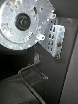

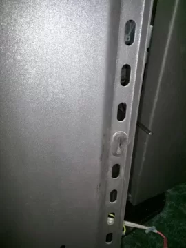

Well... I continue to fall in love with mine. Now to figure out a means of adjusting the damper without disassembling one side of the stove...
here is what I did

then when the side panel is on the the rod sticks out through the rubber grommet

Rich... Did you use a welding rod? And how has it worked for you? A bit more detail... What changes did you notice regarding pellet usage and quality of flame? Thanks!
No it's not a welding rod just a piece of rod that is threaded on the one end. Drilled a hole in the gate then put a washer on the rod as a stop then a nut to hold the rod. I adjusted it to dial the stove in then never moved it after that.

No it's not a welding rod just a piece of rod that is threaded on the one end. Drilled a hole in the gate then put one nut on the rod as a stop nut then another to hold the rod. I adjusted it to dial the stove in then never moved it after that.
Thank you. What was the results... Did you use less pellets? What were the benefits of using your modification?
really did not affect pellet use but allows on the fly adjustment to dial in the stove for what ever pellets you are burning.Once I had the stove dialed in I never had to touch the air flow and I burned a many different pellets.
