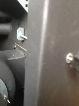

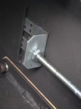

How did others install a extension rod through the side panel? Would be great not to remove that side panel every time. (Last couple days I’ve gotten the “high temp” shutdown code

My solution....all thread, a nutzert, a t handle, and a couple nuts.
