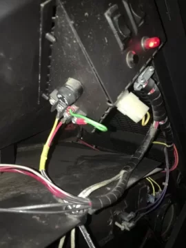

I can see a green light on control board, but it will not feed pellets
I even hooked up new Tcouple outside stove and heated with a lighter and got green light, but stove will not feed

Try reversing the thermocouple wires. A lot of the aftermarket are reversed. Snap disc #2 controls the auger feed along with the hopper switch so check them also

replaced the T couple this AM and still had issues.
Took out the control board and took it to local dealer and we put in floor model and confirmed it was the control board.
new control board and it is running like a champ !!
