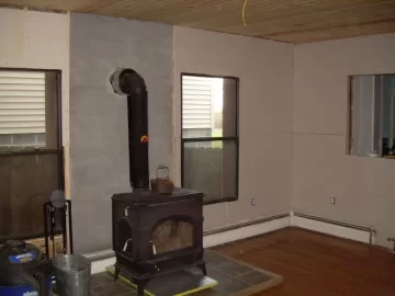

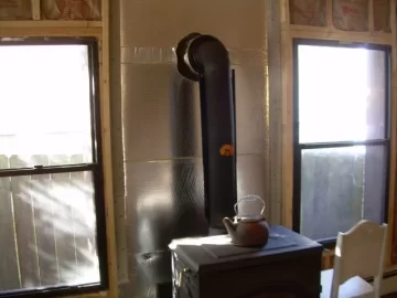

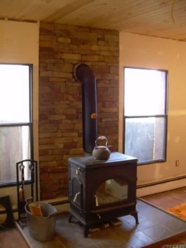

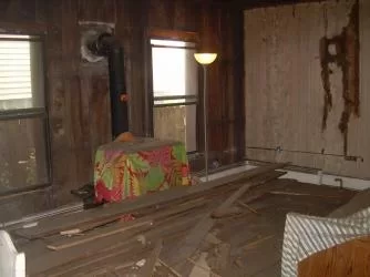

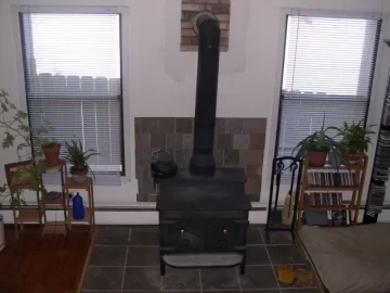

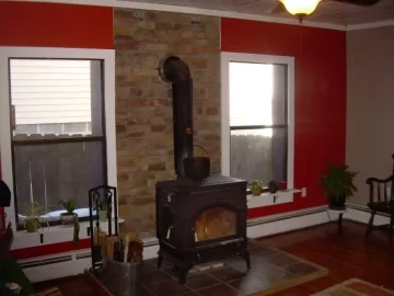

Here's a few pics of my renovations over the past few months. Going from the ol' smoke dragon (far from within any kind of code) to my new set-up (hopefully way over kill). Enjoy

I like the middle pic...reminds me of my place. Rick
Nice job !!!
I have to agree with Rick, my place looked like that alot over the past 10 years :coolsmirk:
It looks like a dutchwest but is it the cat version?
DW Large 2479 (everburn)
Perfect set up for viewing...you're gonna rediscover fire.
doesn't look like you have a blower? I use to be not a big fan of them. Recently came around to accepting them thanks to the wife and am much happier ... they can raise the outer limits 5*.
Nice Job looks great!!!
Hopefully you won't need to use all of that baseboard
Looks great!! Definately a major improvement over your old setup!!
Ray
what is that behind the stove is that paneling or culthurd stone? i need to do something like that cause the plaster behind the stove is cracking. please let me know and if you have any other pics id like to see them please post instalation pics if you have any more . thanks
I like the after. The middle one not so much.

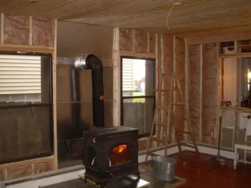

It's manufactured stone--"Stonecraft" from lowe's. It's the "drystack chardonnay". The picture doesn't really do the dry stack justice. In the middle pic posted above, I met the clearance to combustibles--just barely. I wanted over kill though, as I built the wall out with my non-combustibles. The reason is because if you look at the original set up in the first picture, I was a house fire waiting to happen. Therefore, I bought some 1" thick, fiberglass, foil faced, high temp insulation (rated to 450*) and attached it directly to the tongue and groove boards that you see in the middle pic above. Then I ripped 3" wide strips of 1/2 in durock (doubled them up to make 1") and attached them to the foil faced insulation giving me a 1' airspace. They were attached on each side and then a strip up the middle (which you don't see in the pics). The next layer was 1/2" durock, then the metal lathe, then a scratch coat and then the stone. I ran the durock strips vertically, and cut holes in the bottom and the top of the lathe/durock to allow for ventilation within the 1' air space. In terms of attaching the stone, I would recommend watching the videos that most manufactures have on their website. They cover things like the metal lathe, the scratch coat and wetting the rock/scratch coat before applying the stone. Hope this helps.
Pics below:
Pic 1= high temp insulation
Pic 2= furring strips
Pic 3= scratch coat
Pic 4= final product
