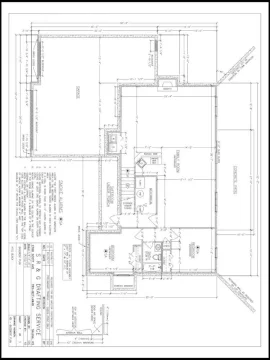

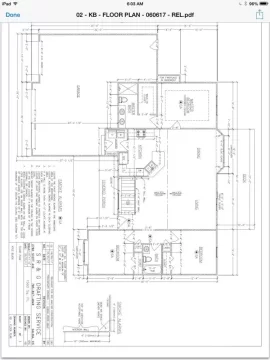

Here is the floor plan so you have a better idea what I am talking about

You will insulate the walls surrounding the fireplace up the fire stop. The top of the firestop would be insulated up to the attic insulation shield. From that point up you would insulate the house wall of the chase.
Builders all too often don’t insulate around the Fireplace, instead they just insulate the house wall. Leaving the entire cantilevered chase exposed to the cold. It makes for a very cold Fireplace!
I understand insulating all the walls up to the firestop, but the fireplace will be in the basement surrounded by earth and concrete so would that still be necessary? People don't really insulate basement walls around here. Where I am getting confused is above the firestop. It doesn't pass through an attic or anything just straight along the side of the house, so there wouldn't be a attic insulation shield would there? Above the firestop would you insulate the exterior walls of the chase only? Or the exterior walls of the house? Really my confusion is above the first firestop where the chase is framed. Sorry for my ignorance. I just want to make sure it gets done right
On the firestop there will need to be insulation. The shield is to prevent insulation from contacting the pipe. The exterior walls don’t need to be insulated from this point up. Just the front wall for the chase, that is the house wall.
Insulation is important in the basement, very important. The earth is a giant heat sink, sucking much of the heat from the fireplace into the earth.
