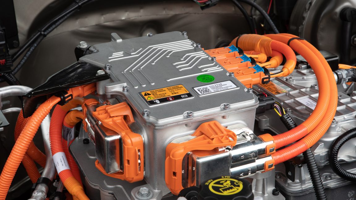

A new package consisting of a Bolt electric drive plus a 60KW battery pack will be coming to the conversion market next year. It's the first step to some interesting conversions. The critique after the article points out some of the flaws, but this is an interesting first step for e-retrofits.
Color me skeptical. Sure, the drive unit will fit easily in the space previously occupied by an ICE engine, but where do you stash the 900 lb battery which is longer and wider than most cabins? The conversion shown looks like they jacked up the cabin several inches and stuffed it in there?
The picture shows they put the battery pack in the bed. That pack shape is not ideal, a flat pack could be mounted under the body. As for the pack weight don't forget that the electric motor weighs much less than a V8 so the weight gain is not as significant. The transmission could also be eliminated with a small gear reduction unit. Also compared to the Tesla units the Bolt drive unit is much bulkier than it needs to be and takes up way too much space up front.
