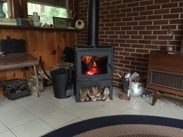

Hey all, since I'm in the south my chimney may not always be warm enough to keep critters away. I used a piece of the expanded metal gutter guard around it to keep birds from hanging out. Can I leave it in place when burning? I'm just worried as soon as I remove it we will have a string of 60 degree days and someone may move in. tia
Oh yeah....first real fire.
