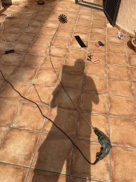

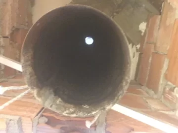

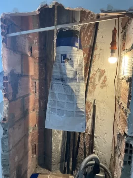

The existing galvanized tube is 20 years old, the age of this house. Not in the US, but in Spain, so the rules may be different. I cleaned it with a rotating brush set, 550 grams soot and grit removed, it looks okay so far. Not rusted. Taking it out seems not necessary, as I'll use it as the outer wall from now on. And it's a lot of hassle to remove it! (The 20 cm tube is inside a masonry chimney)

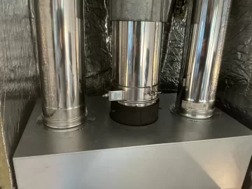

The flue pipe materials arrived, The pipes have been inserted in the existing channel, the new stove is up and running.
I had the choice between inox 304 and 316, 316 being more corrosion resistant, and a bit more expensive. Opted for 316, Dinak SW (single walled).
The new 18 cm inox pipes do NOT fit the 20 cm galvanized tune WITH the clamps on. The bolt makes the whole thing just a bit too wide to fit. But, these pipes have notches at the male end that fit a groove in the female end. Once inserted it’s not easy to separate them. I tried with one pair, and used quite a bit of force, but could not pull them apart.

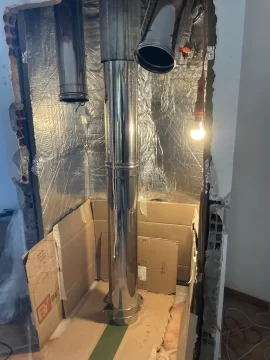

The manufacturer (Dinak) states that chimneys up to 3 meters can do without clamps. They do not elaborate on the conditions, like how it is to be supported in that case. Mine is 5 meters, I decided I can do without clamps, and support the tube from below, and clamp it at the top.

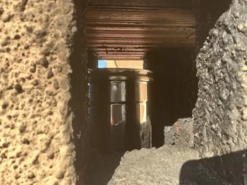

Pity there’s no room for rockwool in between the new and old pipe, so the inox tube is simply inserted in the existing galvanised tube.. That channel is not entirely straight, so insertion did need a bit of wiggling. But it went well.
