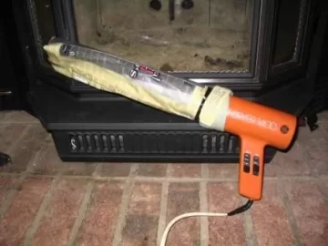

Best method, by far, is the use of an old hair dryer. I constructed a little snout for it out of old plastic to fit above the baffle. (Might be able to post pic later). This method works like magic. Only 30-60 seconds of blowing and the draft is usually reversed.

I used to use a butane torch directed into the stove pipe through the open damper on my old VC stove. After I installed the new Oslo last March, I didn't have a downdraft day before the end of the season, but I'm sure I'll experience it during the coming season. With the Oslo, I won't be able to stick the torch up into the pipe. The hair dryer solution sounds like it might work better in a case like this. If that doesn't work, maybe I'll try the leaf blower!
Trying to attach the photo. (If it works...will be the first time for me)
Edit to add: YeeHaa! it worked first try!
The plastic is from an old, fairly heavy, rice cracker bag...with plenty of duct tape.
The velcro strap is an emergency medical item from fire service days. (Antique by now).

Cool. I can see how that can easily direct the hot air past the baffle and up the flu. Thanks for posting.
