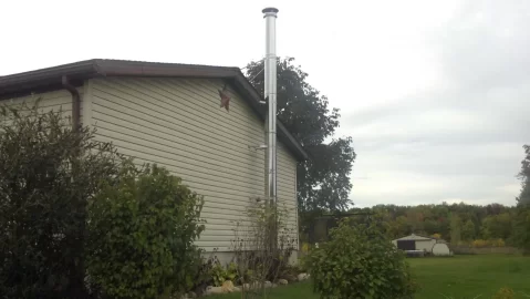

I did it with a masonry chimney. I now rent the house out so no pics unfortunately. I made sure I flashed and caulked it really well.
We have a 15 degree offset instead of notching the soffit, due to the size issue. Not sure if this is an option to consider.
Is it 2" clearance to combustibles? And you just added 2" more for diameter? (10" pipe with 2" per side?).
........Unfortunately the chimney requires 6" inner + 4" insulation + 4" clearance = 14" total diameter/width
I added one more foot of Horizontal and went past the eave. It doesn't look as clean as going through the eave. But I didnt want to cut mine.

Thanks for the photos. The longer horizontal pipe is a good idea for avoiding "the cut" - but because our driveway and a couple windows are on that side, I would rather have an ugly cut.Interesting to see the install where they cut into the fascia. In my case I have to completely cut through.
