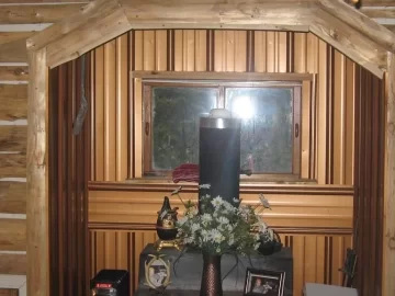

I wouldn't worry either . My kitchen walls are cedar (like one big kindling box ) and ends 21 inches from the sides of my stove with a 14" CTC . The previous owners had this setup which I was leary about though.
  • [Hearth.com] Christmas Tree and Stove
