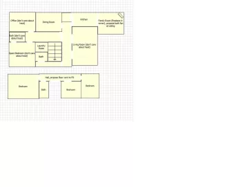

Welcome Michael. Can you post a quick sketch of the first floor plan with door and hallway sizes listed?

Floor Plan...

You would be better off removing cold air from one of the bedrooms. That way you will pull warmer air back into it.
