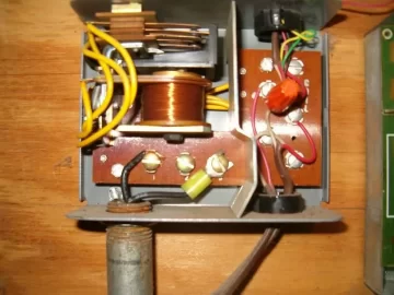

Eliot, here is what the inside of the White Rogers looks like.
thx, Pat

Finding that you have a couple RA832A's was fortunate because they happened to have an extra set of contacts that does exactly what you need. You can continue to use the White Rodgers to control its circulator, but you'll need to add another relay to do what the spare contacts on the RA832A do for free.
The WR in the picture appears to be a normal SPDT relay. The normally open contact is used to switch the circulator on, black wire in, black wire out.
Note that the WR has no transformer. Only the two black wires are 110VAC, all the other wires on the right are 24VAC, and therefore the relay coil is 24VAC and the 24VAC power to drive the relay is coming from somewhere else.
This means the thermostat for the zone is being used to switch 24VAC power to the WR relay coil, which energizes the WR relay, which closes the WR relay contacts, which routes 110VAC power in one black wire and out the other black wire to the pump.
Since there is 24VAC power you can get at that's present on the low voltage terminals of the WR relay, all you need is another 24VAC relay that can be used to switch power to the transfer pump (in parallel with the two RA832A's). The existing thermostat can be used to switch both the WR relay and the new 24VAC relay together at the same time. (You may need to adjust the anticipator setting on the thermostat.)
One of those RIB 24VAC coil standalone relays would do the trick for $25 or so, since you're only switching a couple of amperes of locked-rotor inrush and a few hundred milliamperes steady state current.
--ewd

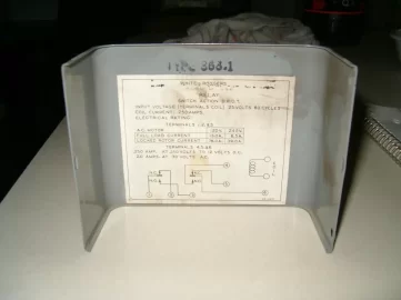

Thanks for the help guys. Eliot, here is a pic of the inside cover of the White Rodgers. It appears to be a DPDT relay?
thx, Pat
  • [Hearth.com] Circulator question ...
Yes it's a DPDT but the two sets of poles are not mix-and-match. Terminals 4-5-6 cannot be used for line voltage and it appears in the prior photo that they are already in use.
(broken link removed to http://cgi.ebay.com/FUNCTIONAL-DEVICES-RIB240-1D-USPP-RIB2401D-/220677557571?pt=BI_Control_Systems_PLCs&hash=item3361684d43#ht_878wt_907)
The RIB2401D coil can be energized with 24VAC or 120VAC, so you can use the switched hot wire coming from the WR relay going to the circ to activate the RIB RIB2401D, which in turn can switch power to the transfer pump.
--ewd

Just the White Rodgers in the photo above. The found-on-site relay in the photo above is DPDT, but one of the sets of contacts is limited to low voltage according to the small print in the schematic for the relay. Pat needs to switch two 120VAC circulators, so NOGO there. But, for instance, that particular relay would work for switching your circulator and the coil current of some other relay.
The Dayton one I bought is rated 15A which is plenty for a 75W circulator I would think.
Plenty for the circulator and the hell yeahs too!
Aren't the poles electrically isolated?
Normally yes, but there's a buhjillion configurations out there so you've got to inspect each one. For instance the Honeywell RA832A pat is using for two of his circulators has one common feeding a pair of NO/NC contacts.
Cheers --ewd

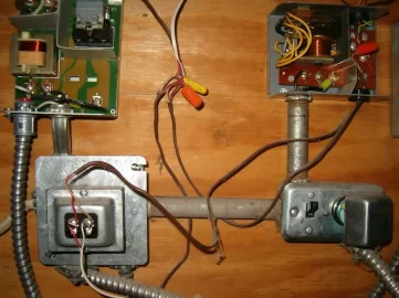

Eliot, after looking at this "menagerie" again, I see that there is what looks to be a seperate transformer going to the 24 VAC side of the WR. Is this correct and does it make the WR usable for my situation?
thx, Pat
Eliot, just wondering if this would work:
Can I just run a black wire to the #3 terminal on the WR? That terminal is running a circulator now, but why can't I just put another wire coming off that same terminal going to the transfer pump?
Also, do I really need to run 3 white (neutral) wires? Can't I just run one white wire to a Honeywell, since all the white wires are run in series anyway?
thx, Pat
LOL , OK. I did order the one you suggested a few days ago. I was just looking at the relays again and wondering why it wouldn't work, but needless to say my electrical knowledge is limited !
thx, Pat
ewdudley said:
You need another relay.
