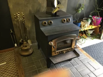

Hello,

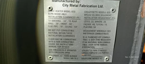

I have a client with a City Metal Wood Stove - apparently sold by Canadian Tire at one time. Model is 820 but I cannot make out clearances for rear and side. Label has been cleaned and some numbers are not visible.
Anyone have installation manual or picture of label for clerances?

In the states this would be an unlisted stove which requires 36" clearances in all directions. These can be reduced to as low as 12" with proper NFPA 211 wall shielding.
