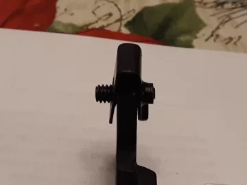

you mean with the set screw? like this?

Yep that’s what I’ve been doing. Have a set of vigilant set screw shelves coming from facebook. Hoping they are the ones that work on the resolute. I’ve heard that some do and some don’t.
